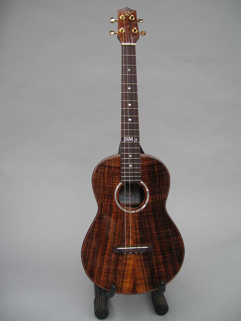

Well I finished my 1st UKE!!!!! This was a total guess!!!! I had no idea
what to do to build this one. Bought a book, emailed John Mayes, and
then adapted!!!
Intestesting story. Well when my first commission was delivered in Dec,
another collegue saw it and said. "can you make a uke" I said "I don't
know, but I can try" Well this nurse wanted one for her father who is
retiring from the military after 38 years. He loves ukes and she wanted to
have a custom baritone made for him as retirement gift. Once I accepted
the challenge, she then told me the hook!!!!!!
IT IS TO BE PRESENTED TO HIM AT A WHITE HOUSE CEREMONY!!!!!
Ouch!!!!! Well it looks nice and I think it sounds fine, but I have NO
means of comparison!!!!
Baritone all Koa uke, EIR bridge and fretboard, red/white/and blue
purfling. MOP and Red white blue rosette. I figured I better make this
one patriotic!!!

WOW, Andy, that is really really beautiful. Nice story too. Do you get to make the presentation???
Great job.
Dang, as fast as you make instruments, you must have the whole night shift working.

PostPosted: Sat Jul 29, 2006 6:28 am
Posts: 886
That Uke Rocks!!!
I really like the details...

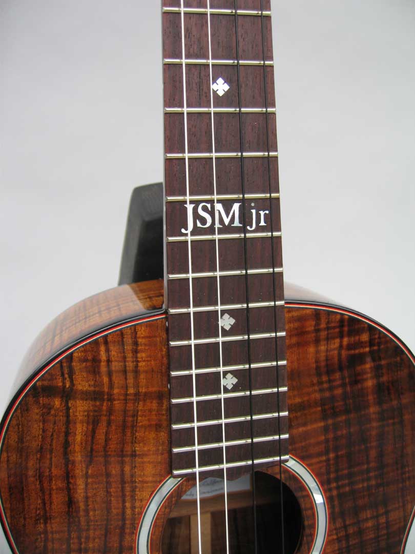

What is the binding and heel cap??
Now I have something to shoot for when builing my sample for the class, I LOVE the FB inlay dots..
Great Work...

Man,That koa is so nice,and great job Andy. Neat story
too!
PostPosted: Sat Jul 29, 2006 6:45 am
Thanks!!!!
Paul, the binding and heel cap are ebony

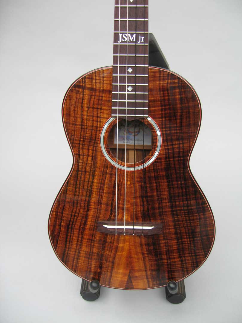

Andy,
Beautiful work and what a great story to go along with it! CONGRATULATIONS!
I too am finishing twin koa ukes and like you have never built a uke before. I would be interested in knowing specs like top thickness, action etc. if you are willing to share.
PostPosted: Sat Jul 29, 2006 2:38 pm
Robbie
Here is what I did
Tops…0.07-075
Back 0.07
Sides 0.065 to 0.07
Action 0.12 at D string
Action 0.10 at E string
This is a DGBE baritone

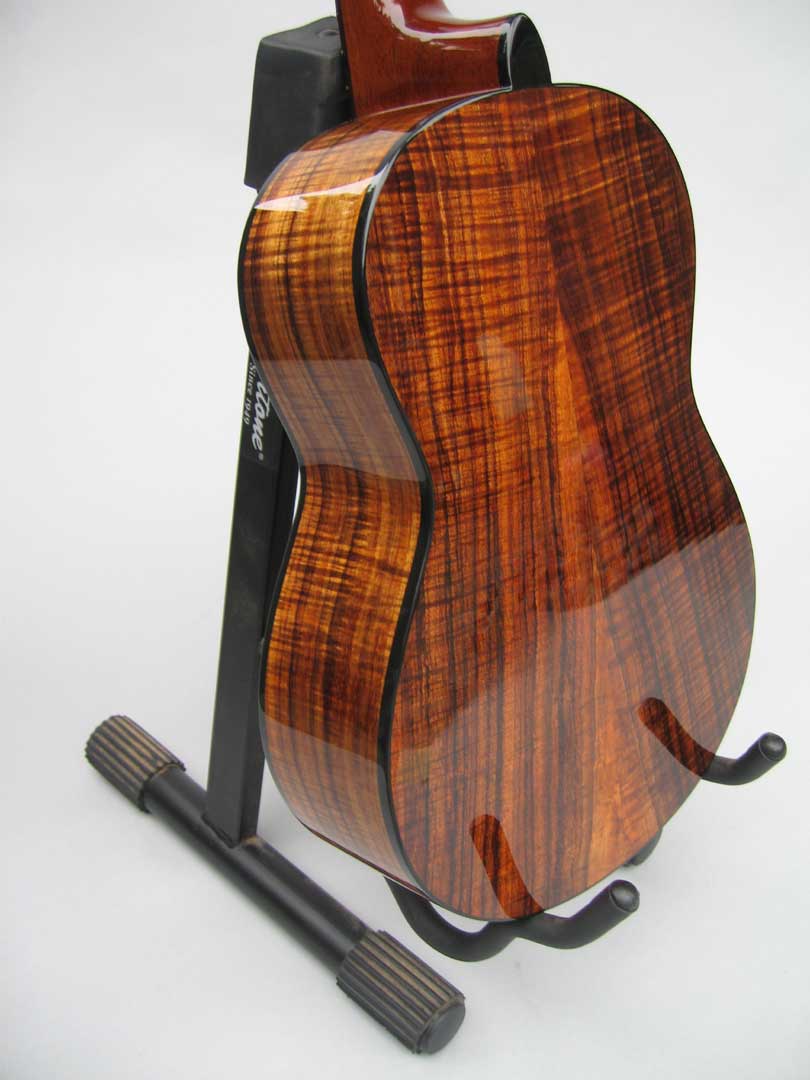

Wow! Or should I say, "Bow Wow!"? What a nice looking instrument. What did you do to that koa? It looks terrific.
PostPosted: Sun Jul 30, 2006 2:12 am
I did nothing to that Koa. That is the way it came. I bought this set of Koa
from Big Island Acoustic Koa in Hawaii. They are not Sponsors, but Josh and
Karen are great to work with. I was in need of a baritone set, but one with a
lot of curl and they would e mail me picts of what they had.
I picked this set despite it being dark, because of the patern and flame
